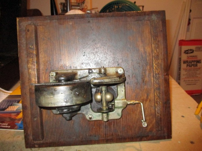

Hi, here I am with another question for more knowledgeable people than myself. I have a Victor VV-IV made in 1917, I was required to replace the tone arm and bracket because it was missing from my machine. I find now that when it is fully wound it starts to play but slows to a stop after only several revolutions of the record, I have tried different reproducers (victor #5) from my working machines, different needles, and even lighter spare reproducers that I had as spares, all with the same result. I took the motor apart and inspected the drive spring, cleaned it (while in the case), and removed all the old grease, I just left WD-40 on it as a test and upon my exam saw no breaks or deformation of the spring. So a long story for a short question. Can these flat motor springs lose power? I know coil springs can become weak over time but don't know if a flat spring can. Any clues or advice you can give would be appreciated, thank you.

Thanks to everyone for their replies and advice. I was trying to clean up old grease using wd 40 not intending to use it as a replacement for grease. I will post some pictures here but you need to understand this machine was mostly a total wreck when I started work on it. I am just trying to salvage what I can of it to be saved for future generations and to learn some stuff along the way if possible. This battle is far from over at this point but I will follow all advice on here when I get back to working on it, this is a 1917 machine-made without sound deflector slats. As someone suggested there may be some bent shafts involved in my problems, I could just look for another motor but that would be too easy, wouldn't it? LOL. Thanks again, guys.
