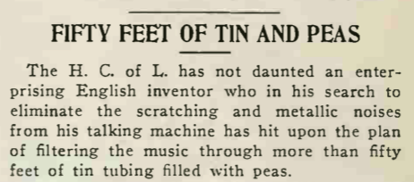

Probably the most interesting solution to the issue of noise suppression comes from the Jan. 1920 issue of The Talking Machine World:
Screenshot 2024-06-23 at 6.25.58 PM.png (85.82 KiB) Viewed 2396 times

Curt A wrote: Sun Jun 23, 2024 6:32 pm Probably the most interesting solution to the issue of noise suppression comes from the Jan. 1920 issue of The Talking Machine World:
Okay, that’s a good one! ;)
