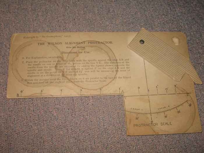

This should enable you to work out which crook is correct. EMG published the useful booklet following the definitive work of Percy Wilson which corrected the errors of the whole industry in the nineteen-twenties. Click on the images for greater clarity.

And alternatively this, also from Percy Wilson (two images AND more importantly, a printable Word document version).

This is all very interesting and thanks for posting the link to print the tracking gauge.
However, the purpose of my post is about Victor Orthophonic machines only and to try and determine how many exist that have had the known tracking area corrected. In summary, this involved changing the sound box crook or in the case of the machines with both the Orthophonic sound box and the Electrical pickup, the 8-60 and 9-40, changing the motor board.
