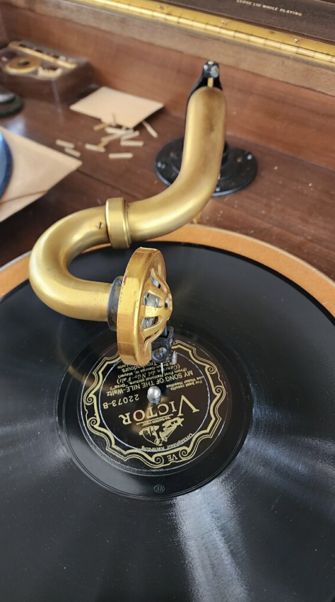

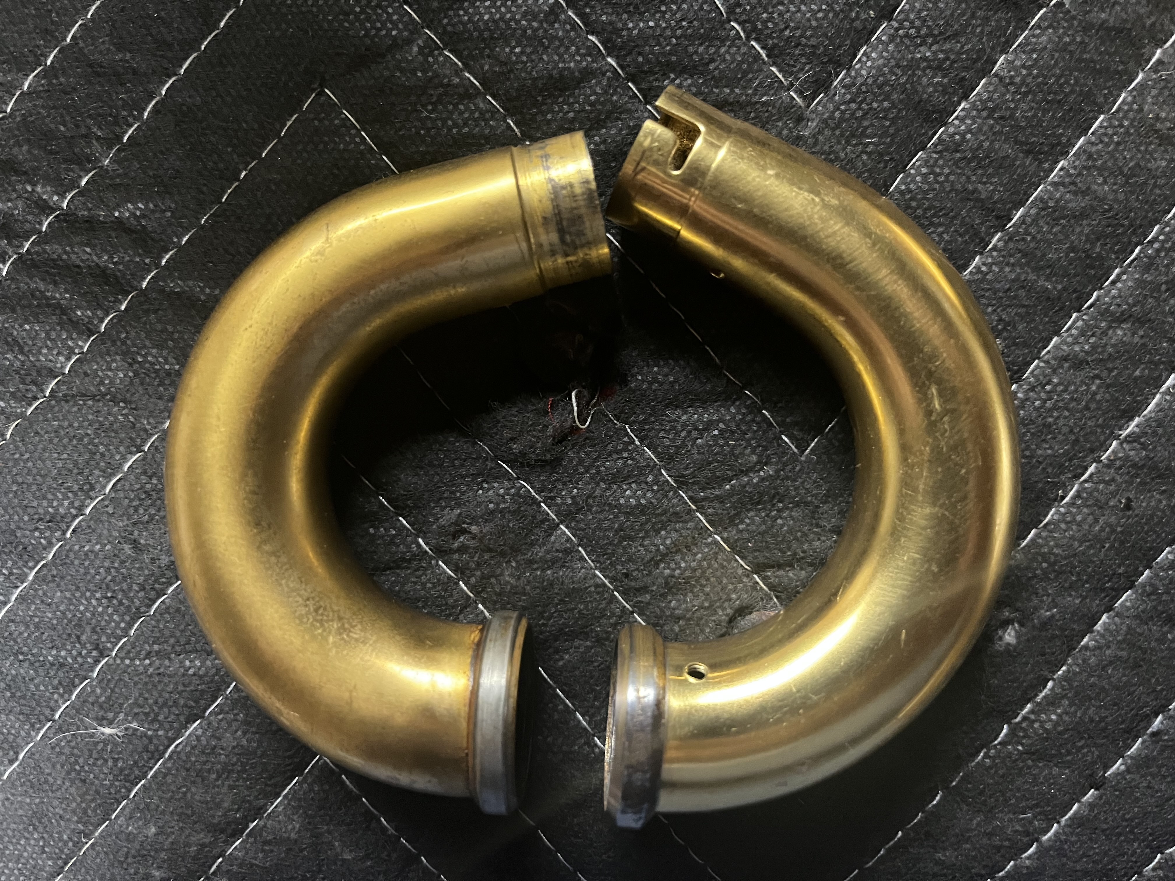

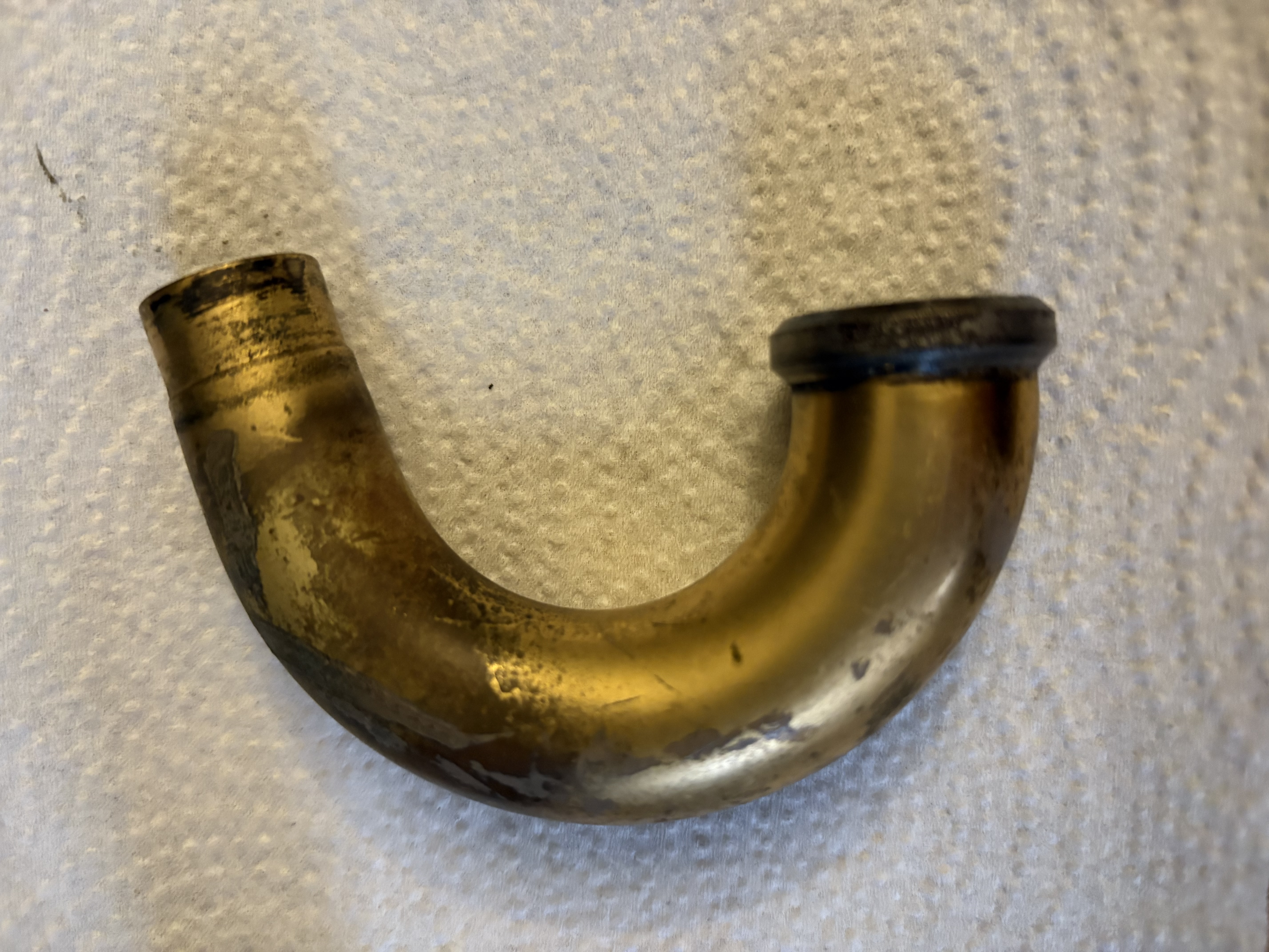

Shown are the original and updated crook on my VE-9-25. The new crook fixed the tracking issue.
How are yours? Please list your model and serial with your reply.

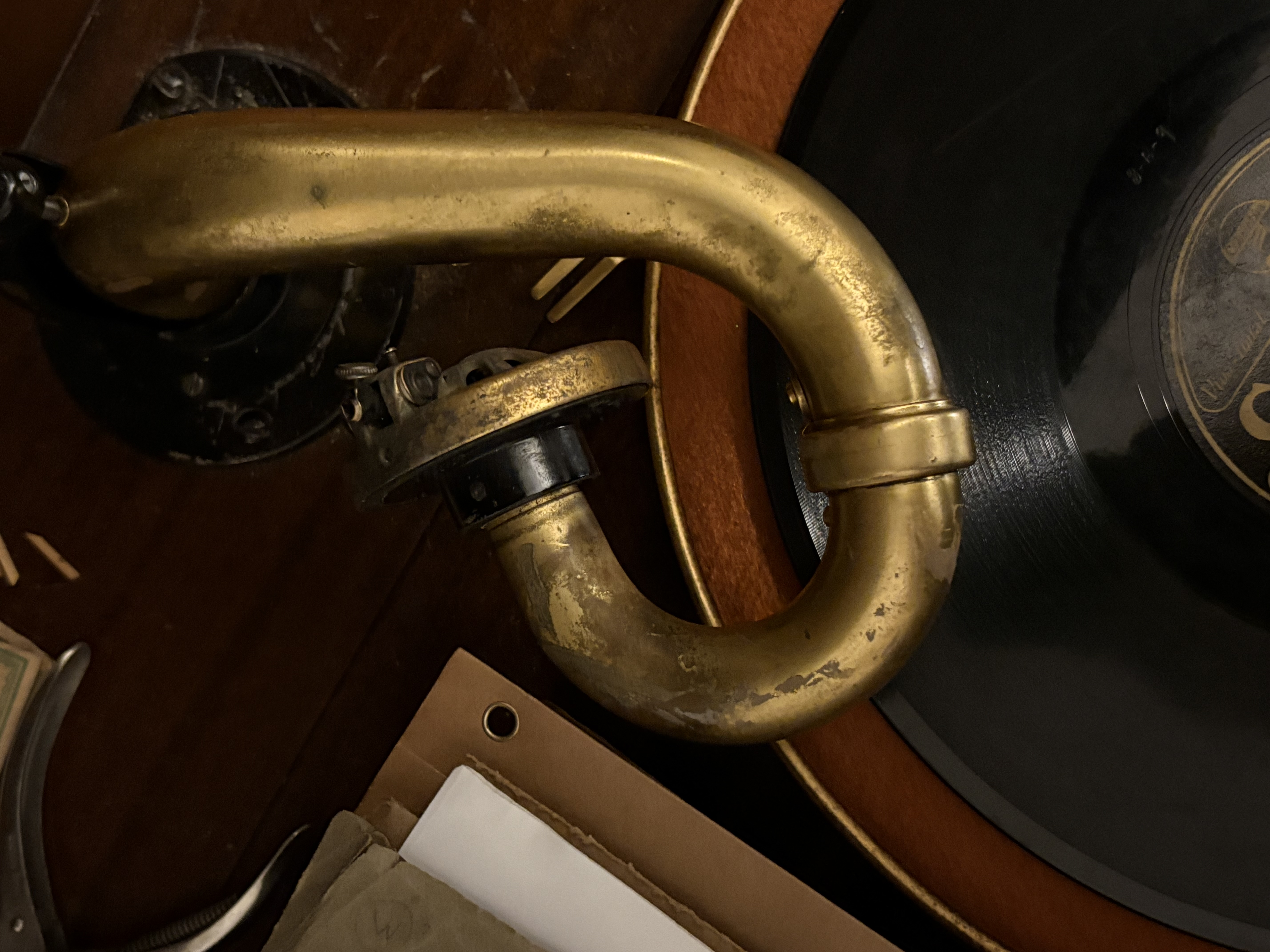

I have a 1926 VV 8-30 serial number 54548, but I can't tell by looking whether the tonearm is the corrected version or not.

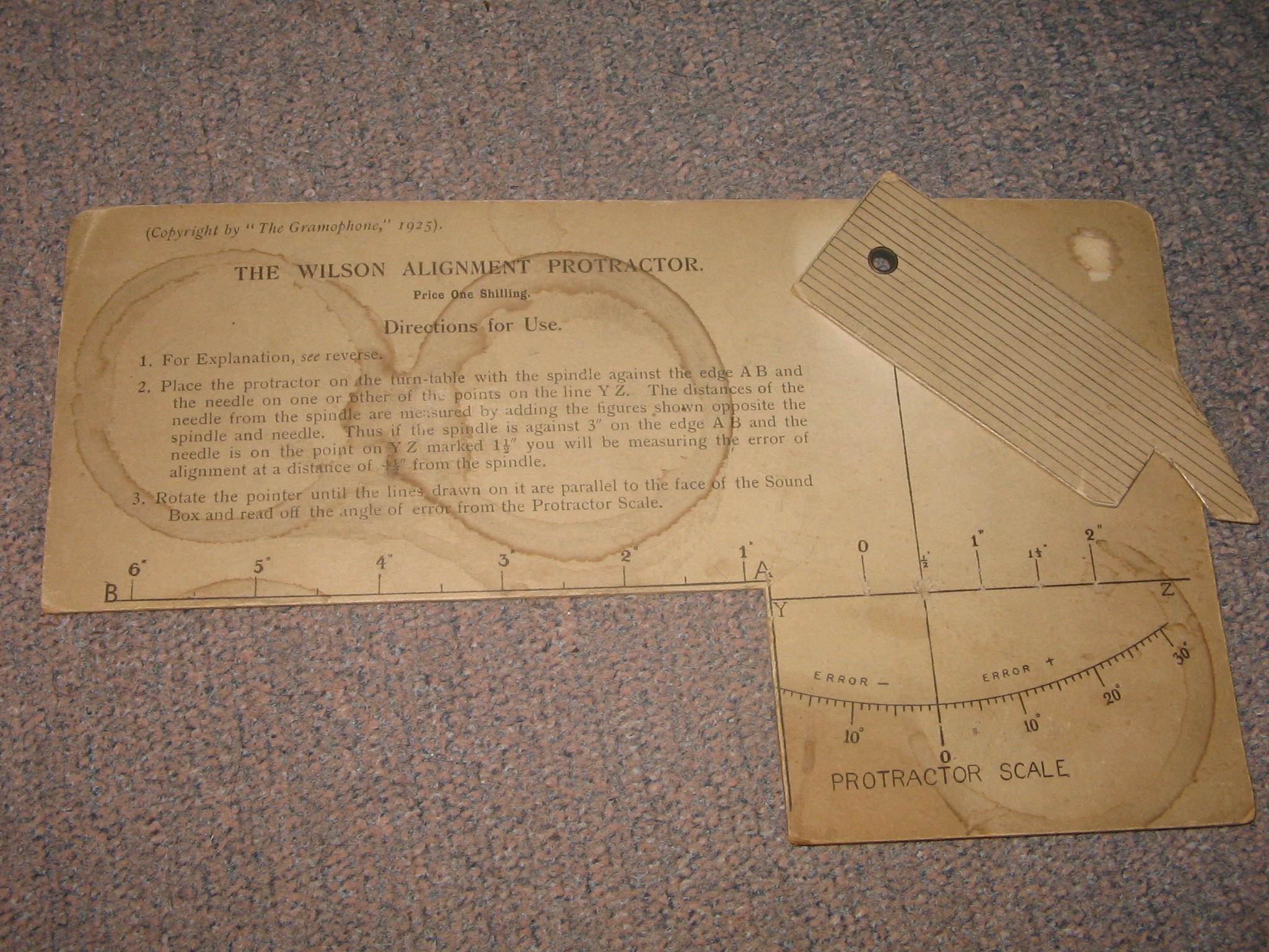

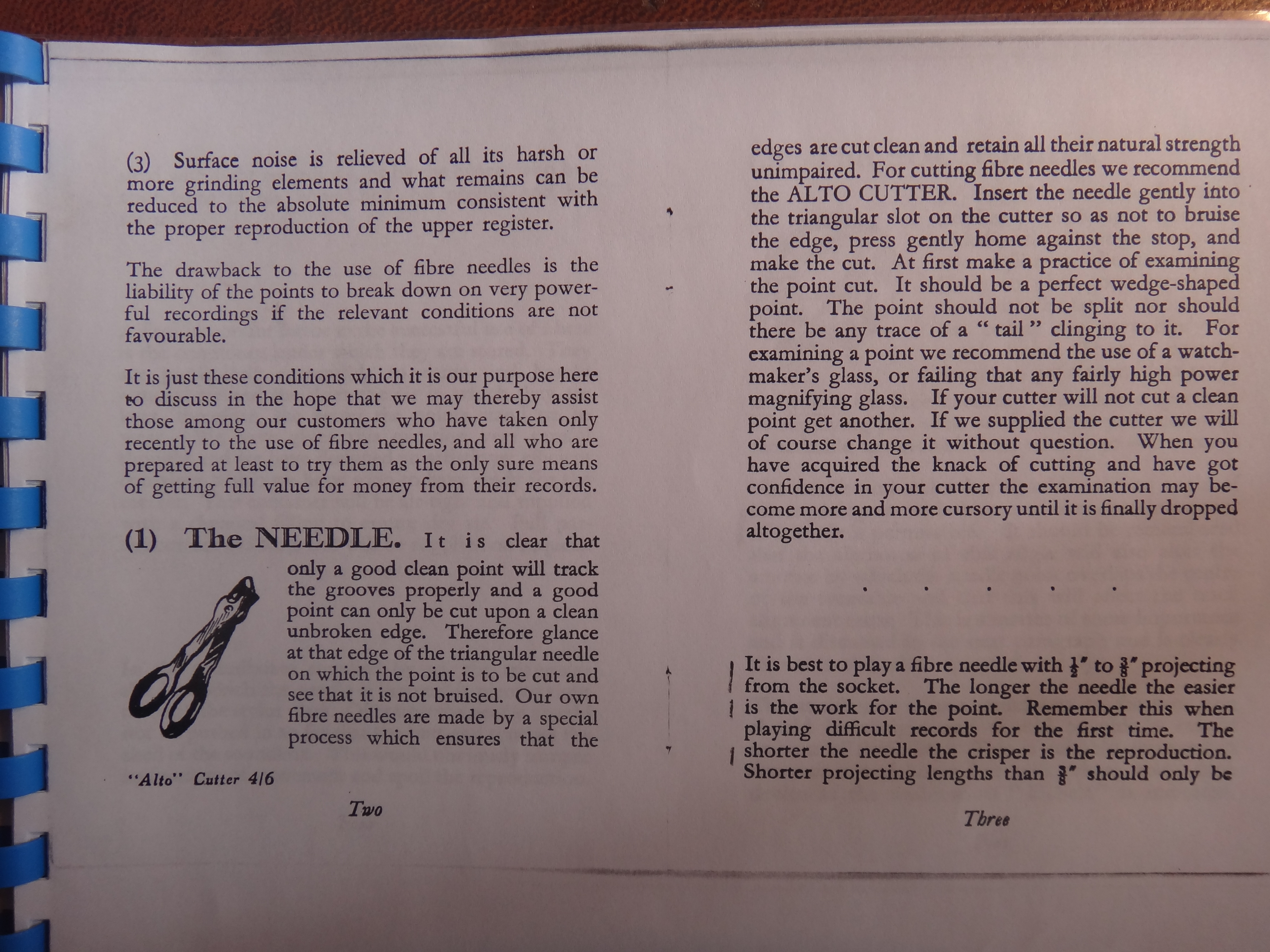

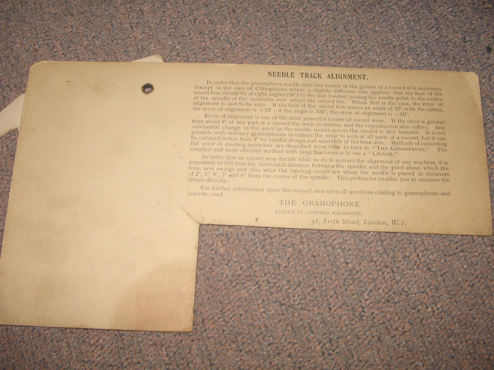

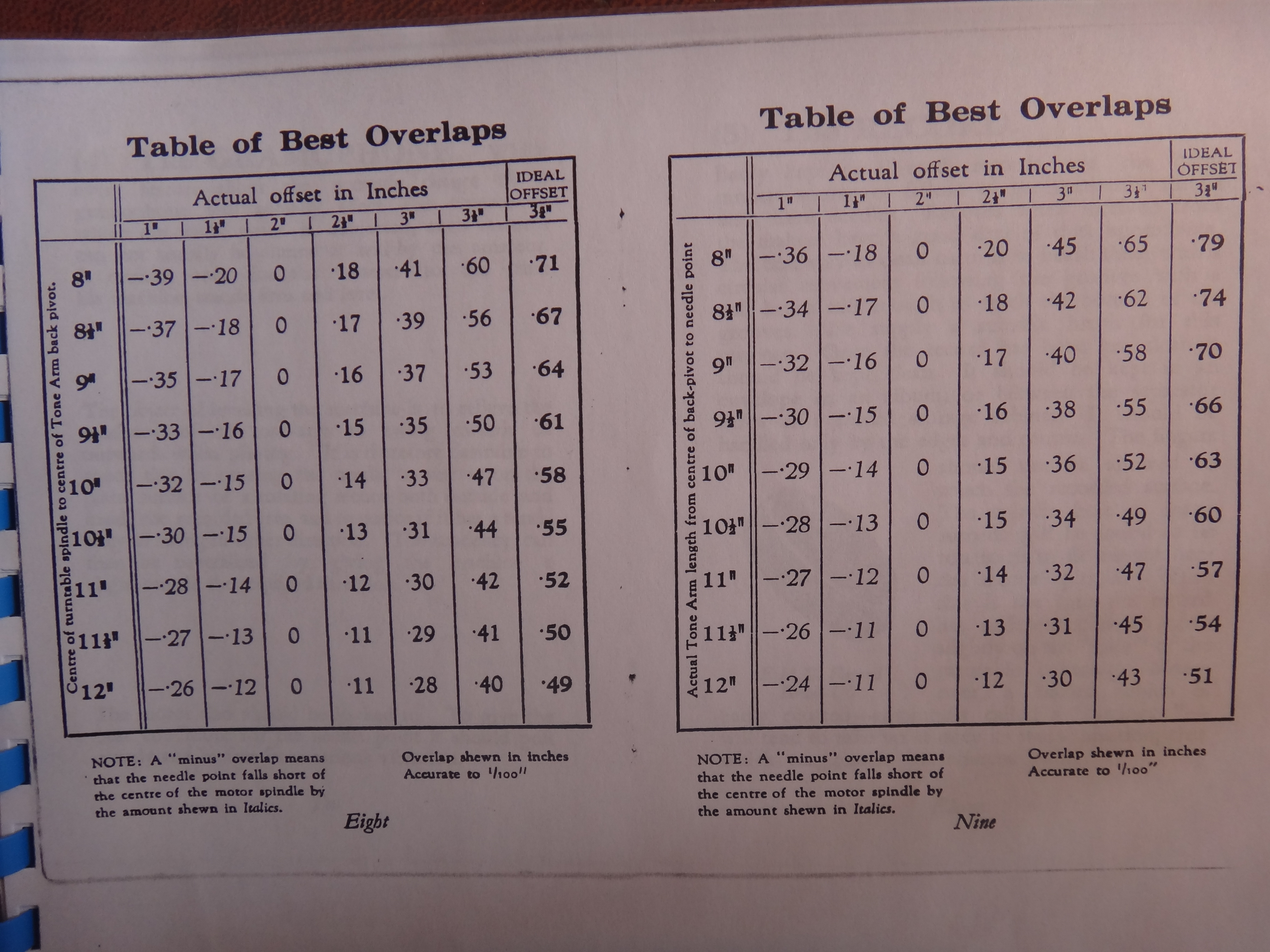

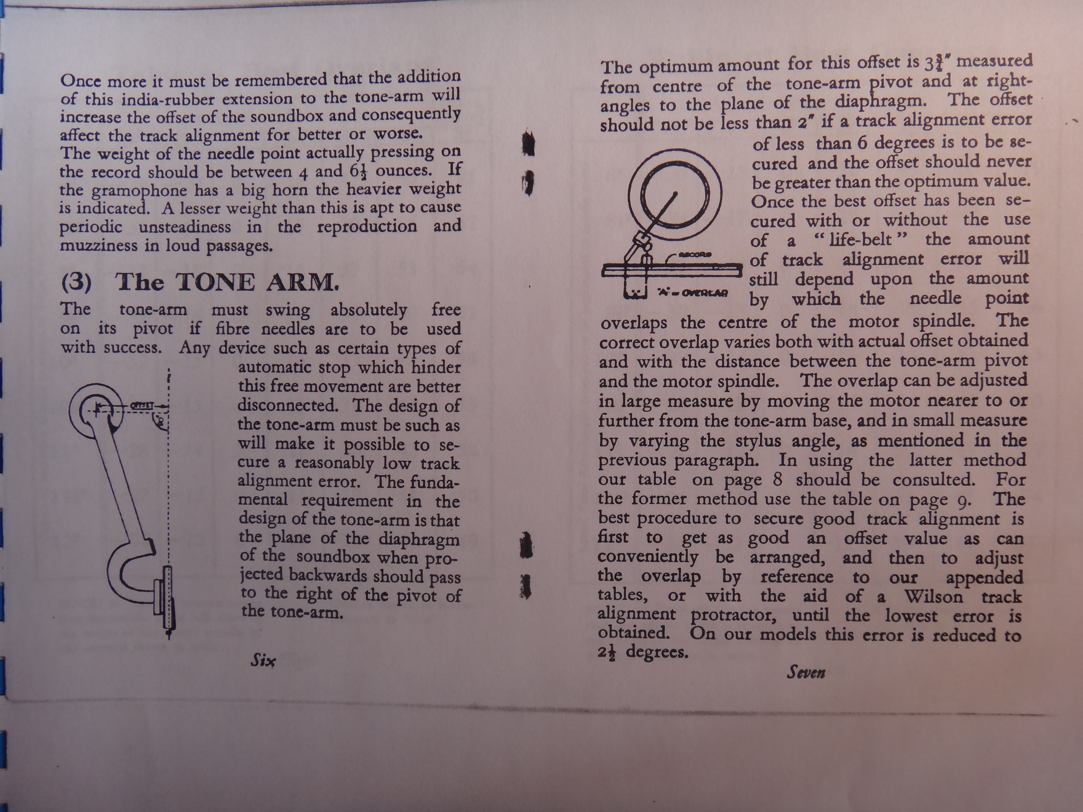

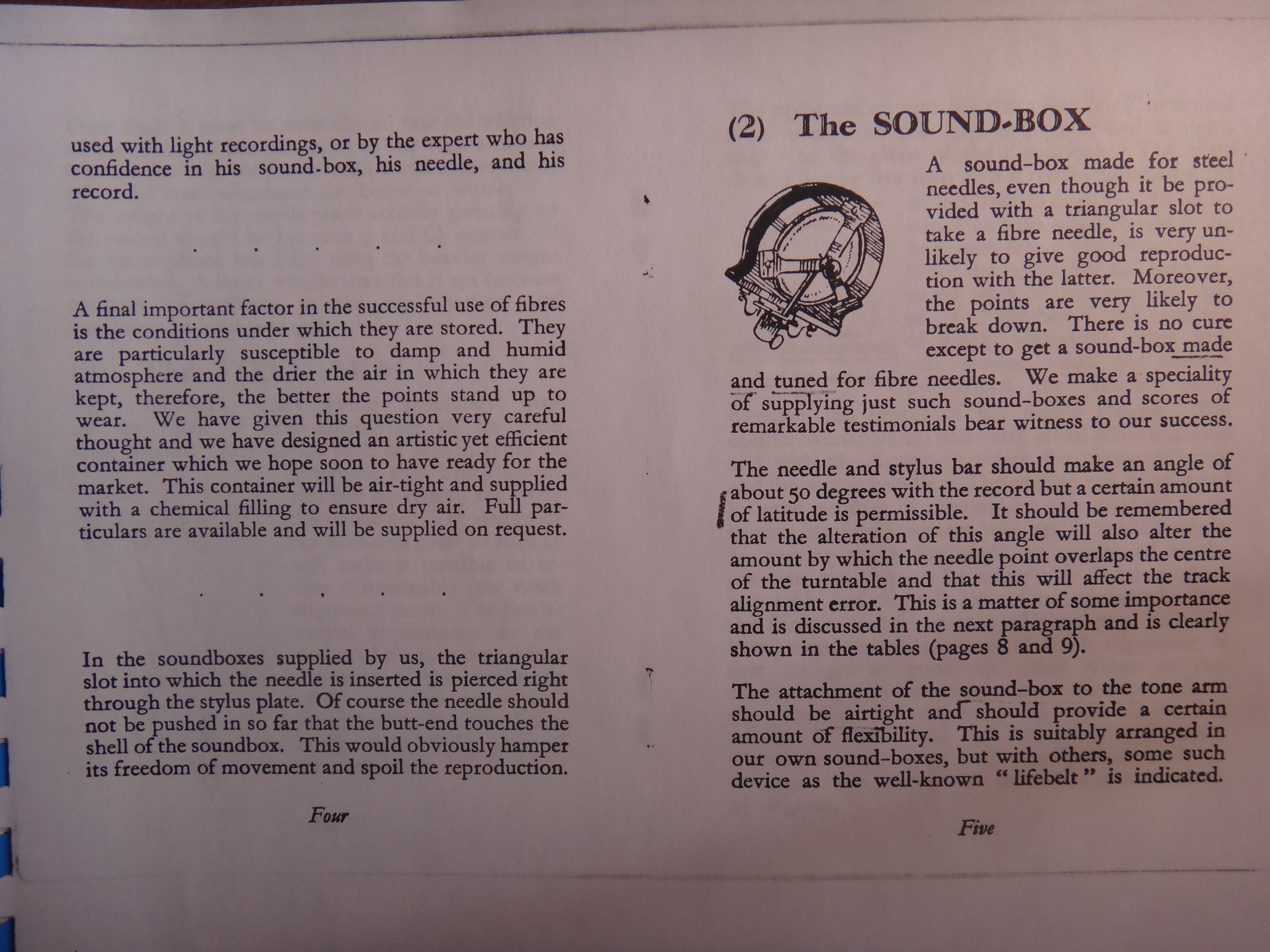

This should enable you to work out which crook is correct. EMG published the useful booklet following the definitive work of Percy Wilson which corrected the errors of the whole industry in the nineteen-twenties. Click on the images for greater clarity.

And alternatively this, also from Percy Wilson (two images AND more importantly, a printable Word document version).

This is all very interesting and thanks for posting the link to print the tracking gauge.

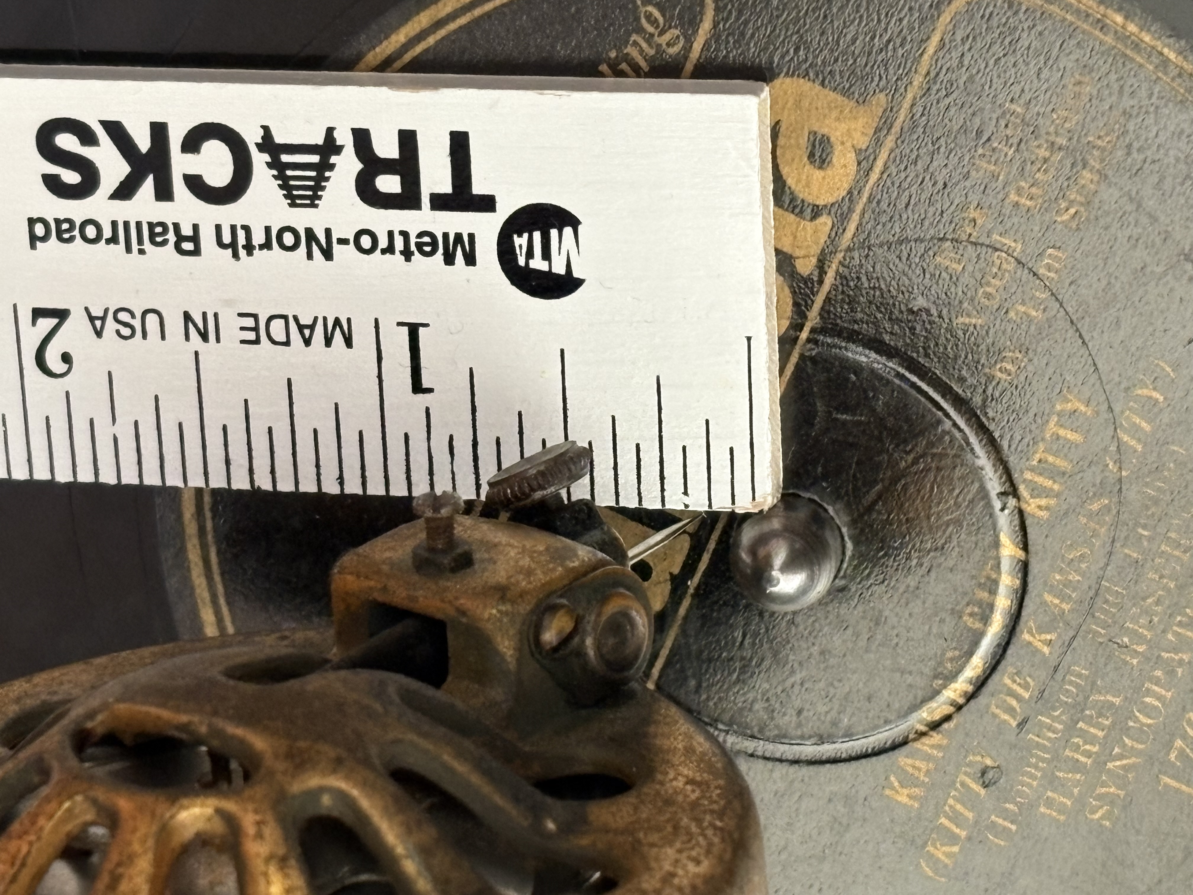

It appears to be about 1/8th of an inch back of the center of the spindle, which would make it a corrected crook. Once again, it’s a VV 8-30 serial number 54548.

Thanks for your report. The parallax angle makes it look more like 4/16” not 1/16” behind the spindle, can you check again please?

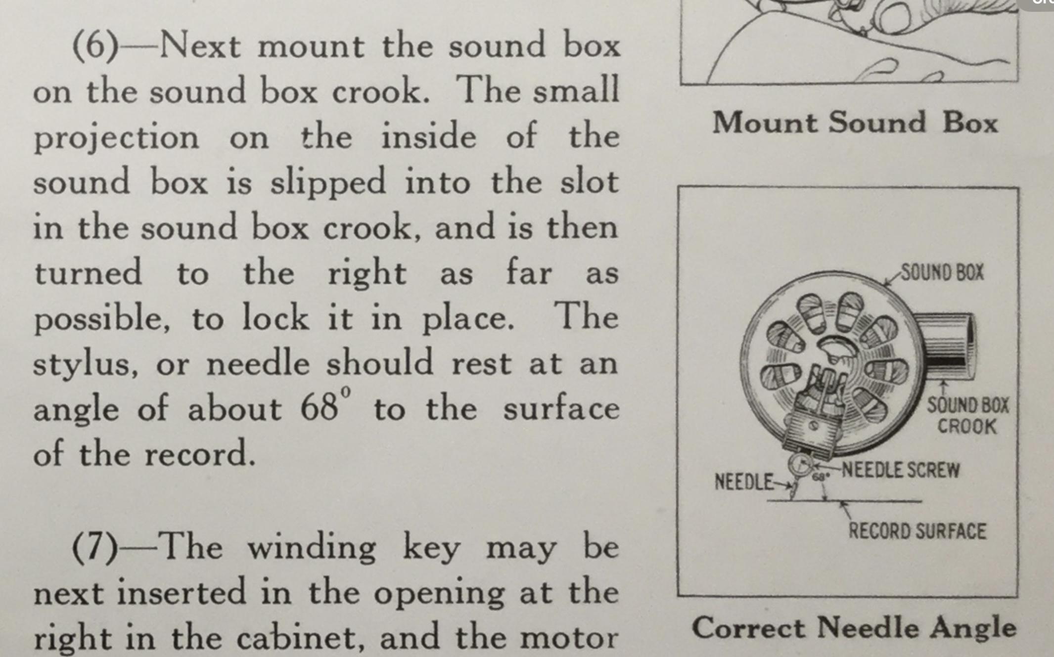

I forgot to mention that when taking the measurements the soundbox should be fully installed and at a 68degree angle.
Mark

I triple checked with a nicer ruler and it appears to be between 3/16th and 1/4th. Taking it apart, it definitely looks like the older obsolete variety. Anyone know where to source the corrected part?
