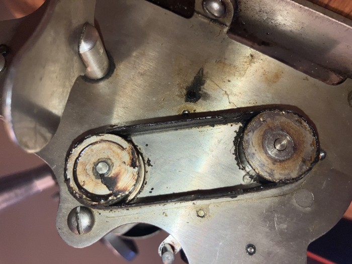

Ok I have installed the new governor spring and it’s still the same no side play issue. But I noticed something.
I took the cover off the belt and was greeted with this. You think I should replace the belt?

Re: Columbia Eagle governor weight spring…replace it?
Absolutely. And both belt pulleys should be clean and dry and in perfect alignment with each other.
Yep. I took the belt off and it literally fell apart in three pieces…FellowCollector wrote: Tue Jul 29, 2025 12:25 pmAbsolutely. And both belt pulleys should be clean and dry and in perfect alignment with each other.
Doug
As for the Carriage issue, I’m just gonna do a swap with my parts machine.
But once again, this machine will be put on the back burner again until I get a new belt.
By the way, is this the proper size belt for a Eagle?FellowCollector wrote: Tue Jul 29, 2025 12:25 pmAbsolutely. And both belt pulleys should be clean and dry and in perfect alignment with each other.
Doug
https://thephonographshop.com/products/ ... eq=uniform
