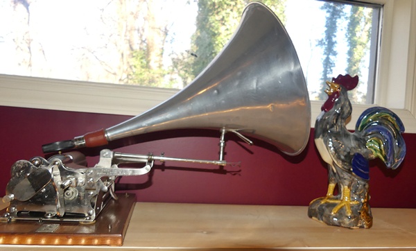

I had a Pathé 0 for a while; it was quite an odd little machine, with a motor design that turned the mandrel backwards. Not really a practical player. I currently have a Pathé 1, which plays better but not what I'd call exactly "well." It's a nice display piece, though, with the cool-looking Systeme Verite horn suspension, and I even found a mascot to go with it. (Photo below; lid not shown.) I think Pathé really came into its own when it shifted to discs.

Pathe 1.JPG (107.52 KiB) Viewed 1674 times
