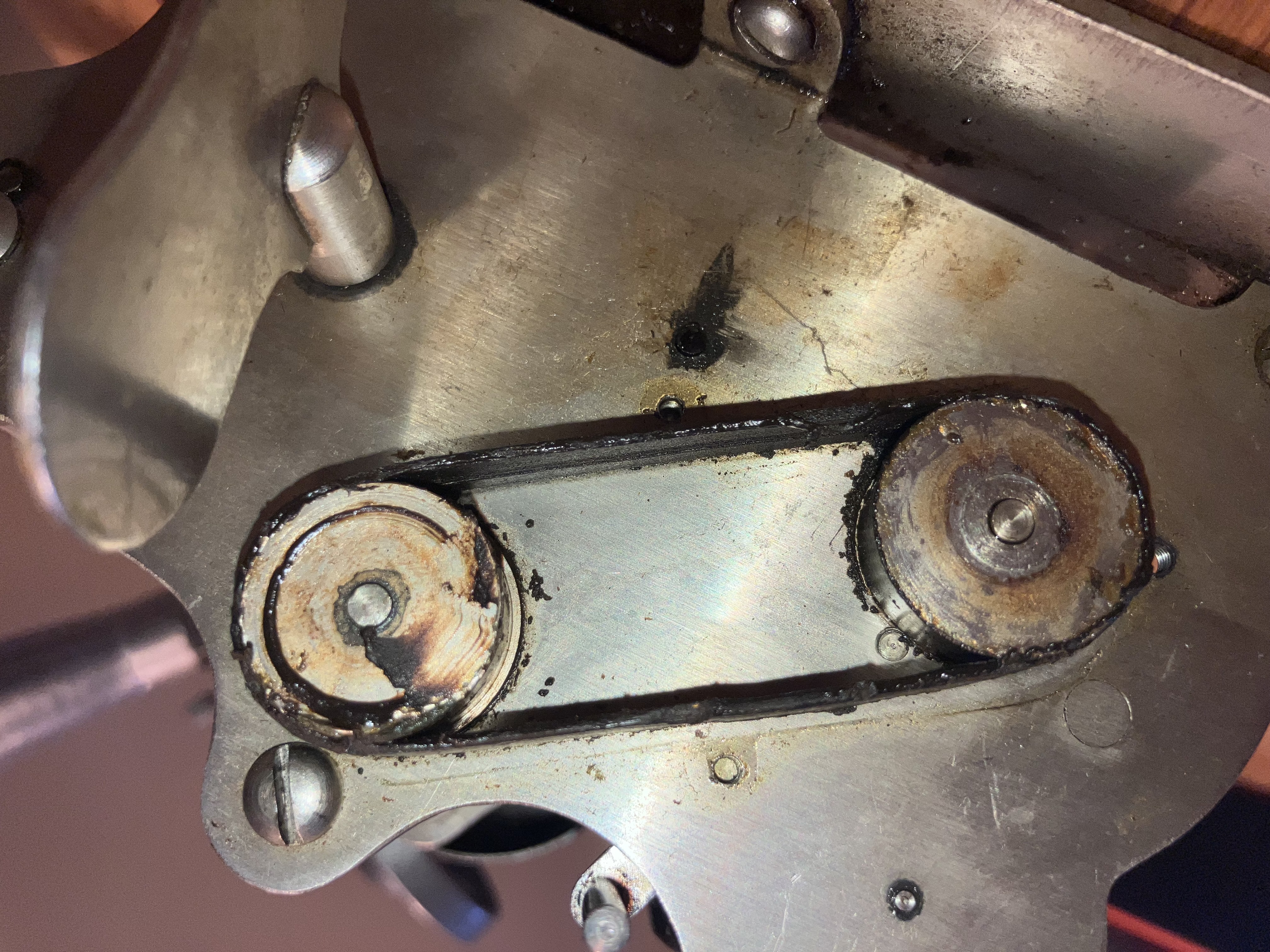

Ok I have installed the new governor spring and it’s still the same no side play issue. But I noticed something.
I took the cover off the belt and was greeted with this. You think I should replace the belt?

Re: Columbia Eagle governor weight spring…replace it?
Absolutely. And both belt pulleys should be clean and dry and in perfect alignment with each other.

- AmberolaAndy
- Posts: 2710
Yep. I took the belt off and it literally fell apart in three pieces…FellowCollector wrote: Tue Jul 29, 2025 12:25 pmAbsolutely. And both belt pulleys should be clean and dry and in perfect alignment with each other.
Doug
As for the Carriage issue, I’m just gonna do a swap with my parts machine.
But once again, this machine will be put on the back burner again until I get a new belt.

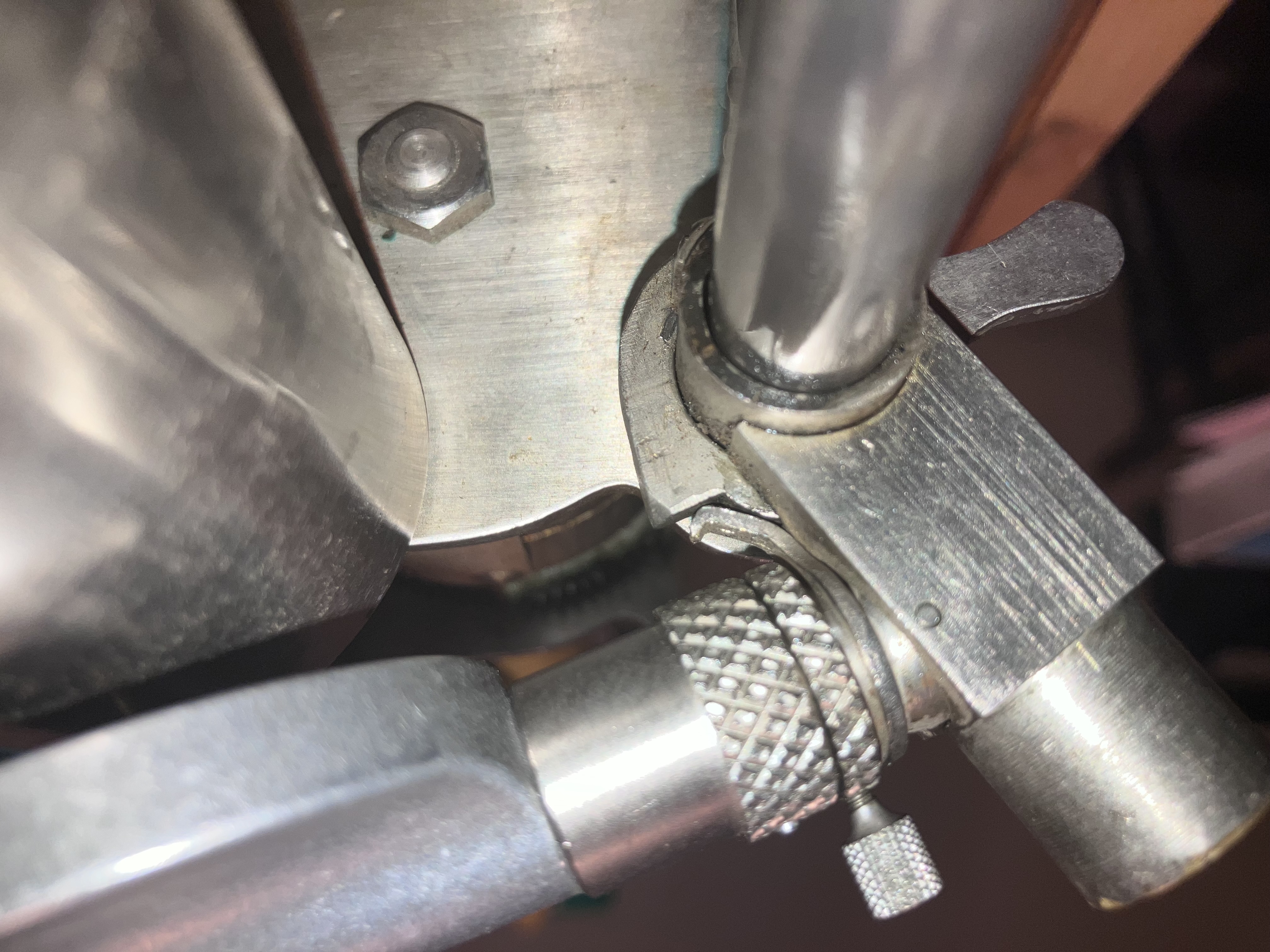

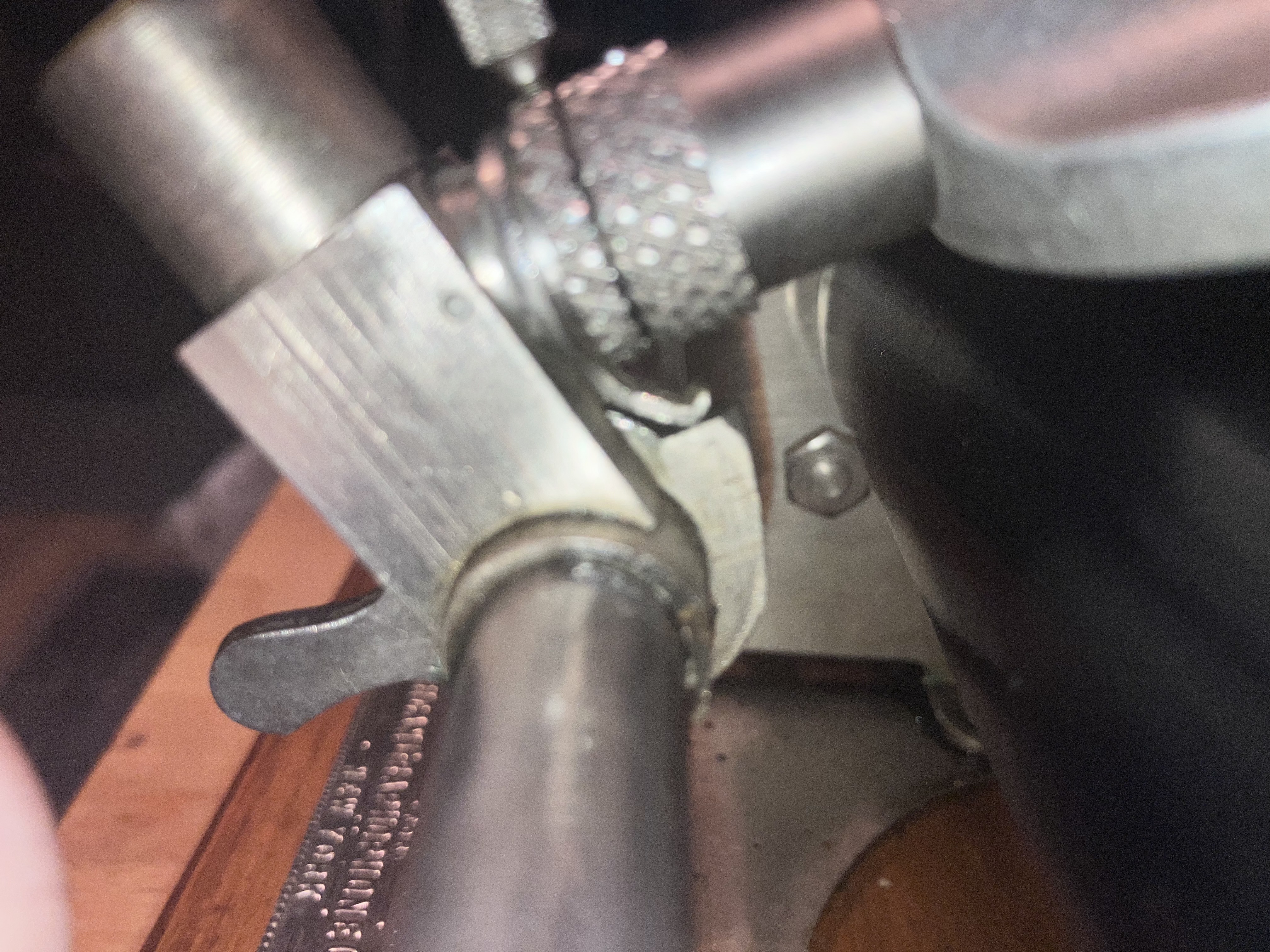

The side play comes from the reproducer and is not a function of the carriage. If possible, just swap out the reproducer only.AmberolaAndy wrote: Tue Jul 29, 2025 12:18 pm Ok I have installed the new governor spring and it’s still the same no side play issue.
- AmberolaAndy
- Posts: 2710
When I get a new belt, I'll pop the reproducer on my Type A on.JerryVan wrote: Tue Jul 29, 2025 2:14 pmThe side play comes from the reproducer and is not a function of the carriage. If possible, just swap out the reproducer only.AmberolaAndy wrote: Tue Jul 29, 2025 12:18 pm Ok I have installed the new governor spring and it’s still the same no side play issue.

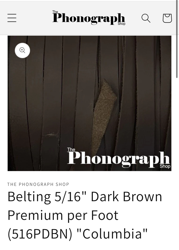

By the way, is this the proper size belt for a Eagle?FellowCollector wrote: Tue Jul 29, 2025 12:25 pmAbsolutely. And both belt pulleys should be clean and dry and in perfect alignment with each other.
Doug
https://thephonographshop.com/products/ ... eq=uniform

Ok back to this machine…
I have ordered this type of belting material. I hope it’s the right one…
