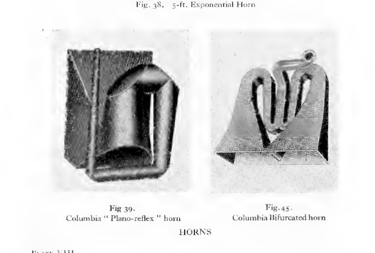

Many thanks for the excellent explanation of the differences between the models. As you noted, the HMV 157 horn is considerably larger than the Viva-Tonal bifurcated horn used in the console models. I was able to find various photos of the HMV 157's horn online, but so far, I can't locate an image of the Viva-Tonal horn. Here's the 157's horn -- HMV's (four chamber) Re-Entrant style horns, of course, were based on those produced in the United States by its sister company, The Victor Talking Machine Co., which had acquired the rights to use the Western Electric recording process, as well as to produce the exponential horn gramophones--also designed by Western Electric. The Gramophone Co. held off on producing these models for about two years after they were introduced in the US--most likely to use up old cabinet stock. (In the US, the earlier Victrola models were disposed of through a half-price sale to the public a few months before the introduction of the new line, dubbed the Orthophonic Victrola.) When they were finally produced in the UK, the horns were manufactured out of metal instead of wood (gumwood?) as they were in the US.Oedipus wrote: Sat Jan 06, 2024 10:31 am ...The 157 was part of the 1928 range, along with the Re-entrant machines. It first went on sale in September 1927, and the 163 and 193 followed in November -- but what's two months between friends? HMV catalogues were careful to apply the term 'Re-entrant' only to the larger models, i.e. those in which the horn divided into four sections. The 157 divides into two, like the Columbia horns, but on a larger scale. The word re-entrant indicates a sudden change of angle, such as you see between adjoining mouth sections in one of these horns, so could have been applied to horns divided in two. It just wasn't. It was, and is, not a term in common use, being largely confined previously to fortifications, so used by military engineers, no doubt. Perhaps that unfamiliarity is why HMV adopted it as a special term, a brand name almost, for their top of the range models.

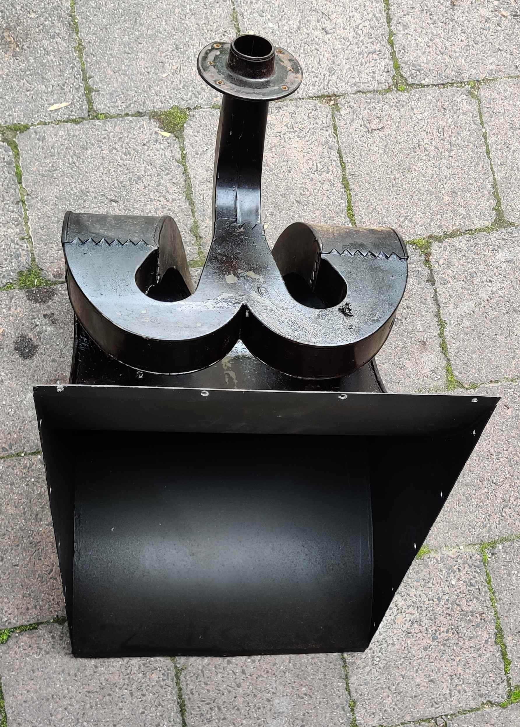

That is correct, although you can't see that in mine without removing the louvre assembly as there is a black cloth covering behind the louvres. It does seem a missed opportunity not to have increased the size of the horn mouth to match the opening in the cabinet.Oedipus wrote: Sat Jan 06, 2024 10:31 am if you look through the open louvres you will see that the actual horn opening is considerably shallower than the height of the louvres........
OrthoFan - the only image of the Viva-Tonal horn that I can find is right at the beginning of this video, and again at about 1.23 in (despite the machine being a different model to the 153a Columbia). It is clearly not as big as the 157 horn.

I was finally able to find this illustration, albeit grainy, of the two common (UK) Viva-Tonal horns culled from Modern Gramophones by Percy Wilson -- ...which is a great reference book, if you haven't read it: OrthoFanAn Balores wrote: Sat Jan 06, 2024 12:49 pmThat is correct, although you can't see that in mine without removing the louvre assembly as there is a black cloth covering behind the louvres. It does seem a missed opportunity not to have increased the size of the horn mouth to match the opening in the cabinet.Oedipus wrote: Sat Jan 06, 2024 10:31 am if you look through the open louvres you will see that the actual horn opening is considerably shallower than the height of the louvres........

Interesting! The 'Plano-reflex' horn is very similar to the Rifanco horn number 816, pictured in my post Horns! of Dec 17th last year.
