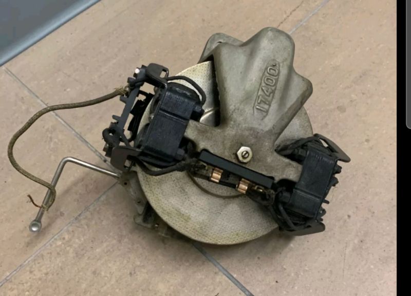

I got a Victor elecric credenza . The motor seems to run fine without playing a record. Quickly stops when playing a record. I know nothing about the electrolas. Any thoughts

This is a symptom of one of the coils being open.
Another forum member was talking to me this evening and noticed the fuse is gone in the crossover wire . Was that ever there? If not then put one in it and try again!
Also for more accurate help, how about showing us a actual photo of "your" Credenza motor instead of something you grabbed off of Ebay.........
Note: This diagram is for a changer so the Credenza will not have the 3.2mfd capacitor.

Re: Electric credenza weak power
Thank you, I will check the windingselectrolaman 64 wrote: Sat Apr 26, 2025 8:53 am This is a symptom of one of the coils being open.
Chris,
Have you made any progress? We noticed that the photo you posted here is from an EBay advertisement. Can you show us your motor if not the same one?
The problem is most likely a weak coil or open wire. BTW the fuse was only used on the earliest versions, it was replaced with a direct wire crossing between the coils, the motor will not run without the fuse or the wire being connected.

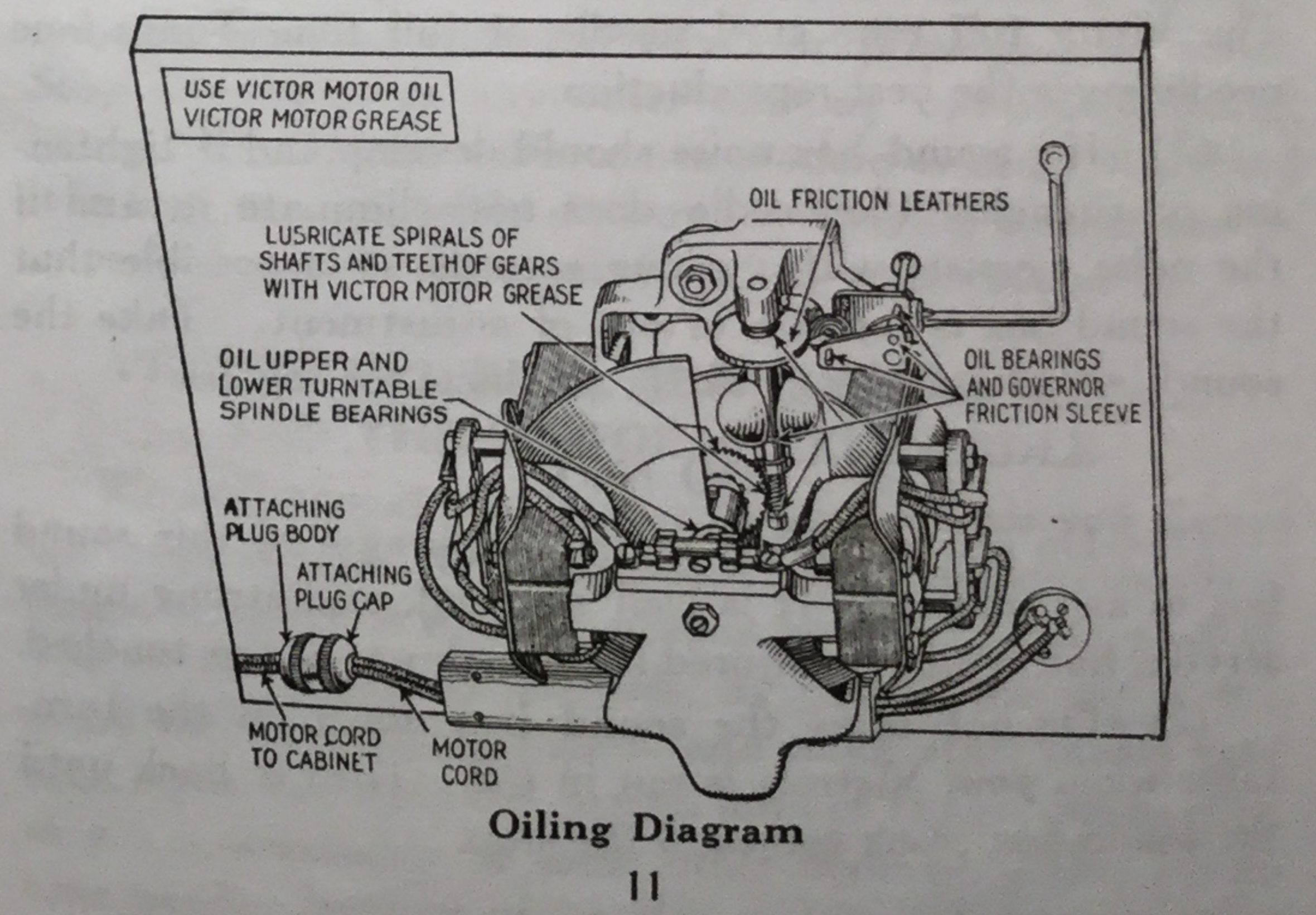

I posted the Victor Service Bulletin for the Induction Disc motor in the Forum Archive section. You can find it here:
viewtopic.php?t=60607
Let us know what you learn.

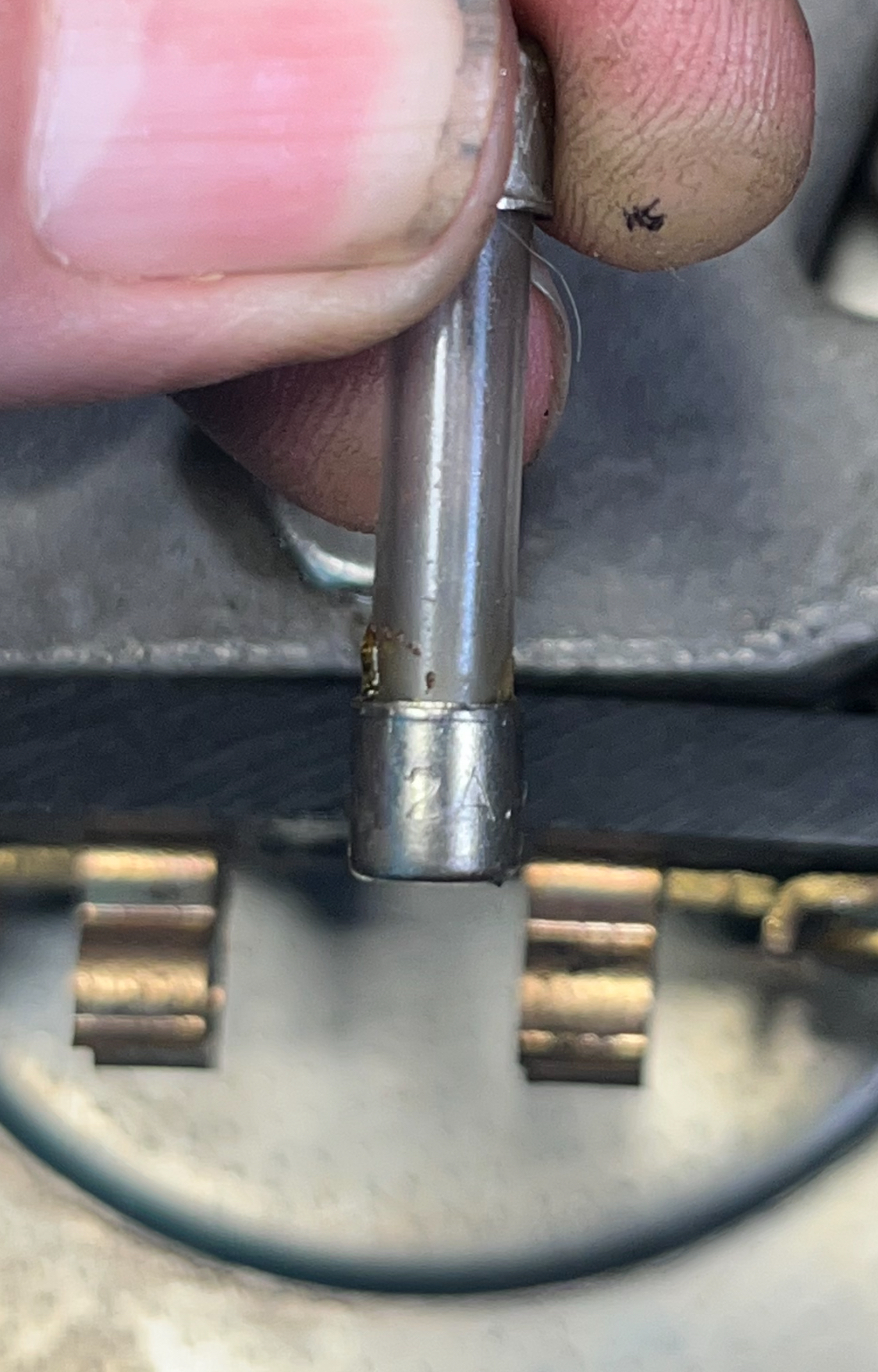

I had an opportunity to work on an early induction disc motor that contains the fuse. Indeed the installed fuse is 2A (250V).
As started earlier the fuse was used to protect the motor if connected to DC mains. The fuse and holder were soon eliminated and replaced with a single wire connecting the two coils.
Mark
