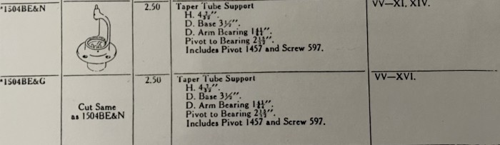

That is a nice document to have, oftentimes these are lost and it is relatively unusual to see them, thanks for posting it.
By the way, SF and DF refer to single face and double face records. RS is Red Seal and I believe PL refers to Purple label, these were the various classes of Victor records.

Jo,
I checked the parts listing for the Type D XVI with the serial number on the tag in your photo. There is no listing for a separate screw, just for the assembled support. The screw listed is for the pivot pin at the top, not at the base. Unfortunately I do not have a Type D XVI in the collection to check. I did look at some XIV and XVIII’s and none have the hole circled in your picture, the casting is uninterrupted. Maybe someone here can check their machine. Is this a two piece support casting?
