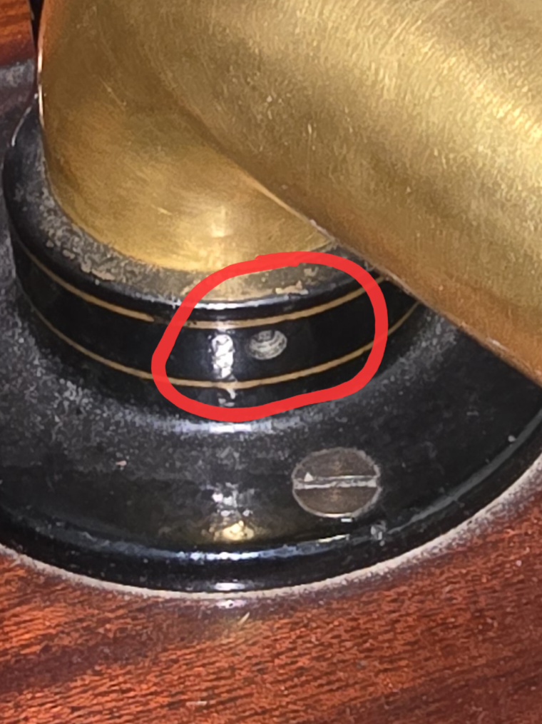

Style VV-IX
Screw went missing during the move. Can anyone help? Thanks for taking a look.

Yes, we can help but we need your real name and the serial number of your VV-IX. This model went through many revisions.

The ID tag is best to determine the series of your machine. You posted about an VV-IX but the tag is for an VV-XVI, which do you have? The gold taper tube in your first posting may indicate you are asking about an XVI.

Jo,
I checked the parts listing for the Type D XVI with the serial number on the tag in your photo. There is no listing for a separate screw, just for the assembled support. The screw listed is for the pivot pin at the top, not at the base. Unfortunately I do not have a Type D XVI in the collection to check. I did look at some XIV and XVIII’s and none have the hole circled in your picture, the casting is uninterrupted. Maybe someone here can check their machine. Is this a two piece support casting?
Mark

Thanks again for your interest and helping me out. I know nothing of these magnificent machines and obtained it at an estate sale. It was cherished by the original owner of the house and I promised to love and care for it as she did. It was working and playing perfectly fine until I brought it home and noticed the piece was loose and wouldn't play anymore. That's when I noticed there is a missing screw. IWhen I look at the tag I see XV it's hard to determine if there's an I at the end. Attaching some more photos.
