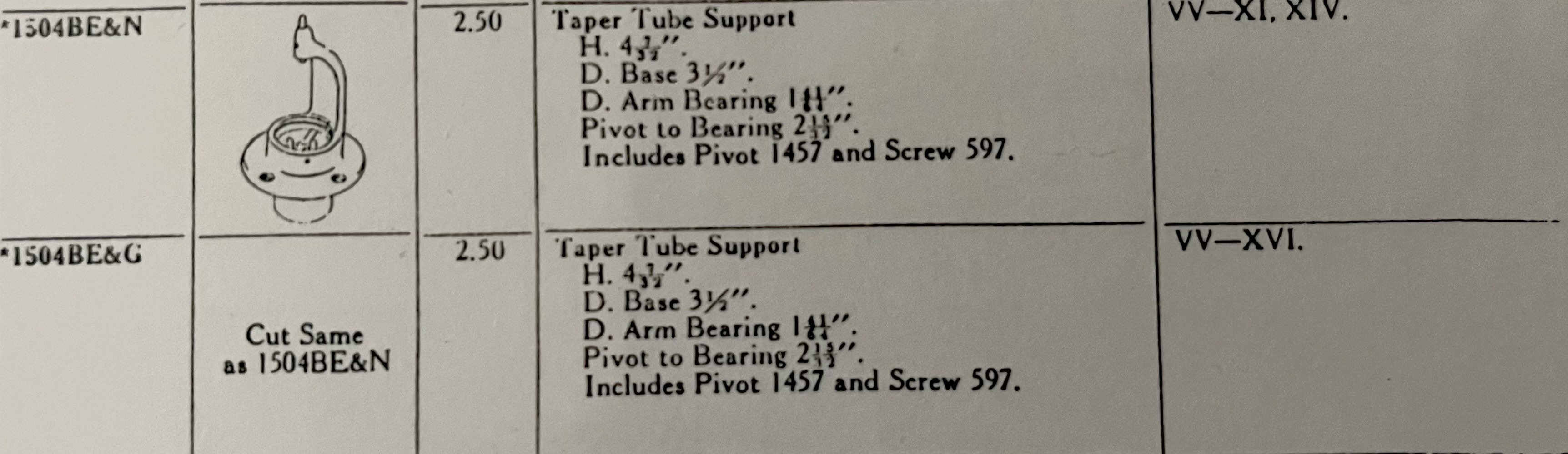

Re: Tone Arm Screw Needed
Jo,
I checked the parts listing for the Type D XVI with the serial number on the tag in your photo. There is no listing for a separate screw, just for the assembled support. The screw listed is for the pivot pin at the top, not at the base. Unfortunately I do not have a Type D XVI in the collection to check. I did look at some XIV and XVIII’s and none have the hole circled in your picture, the casting is uninterrupted. Maybe someone here can check their machine. Is this a two piece support casting?
